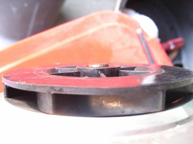

Water pump is back on. I pressed the impeller on another .043 inch. I'll post pictures tomorrow. There was quite a gap on the impellers close to the front housing. This would effective the operation of the pump. Especially at the low RPM's. I don't think this was the problem but it will help.

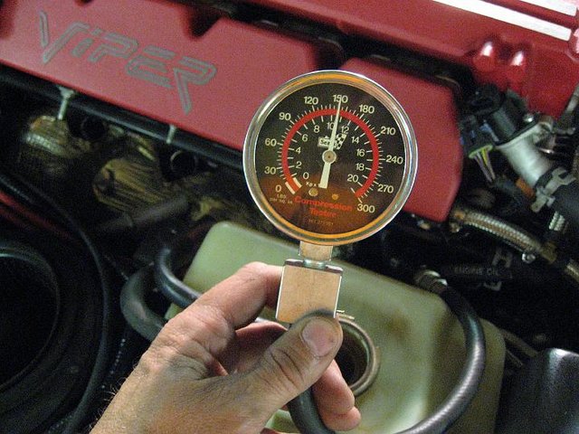

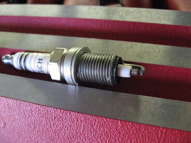

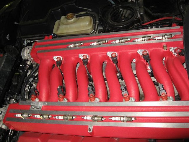

Quote:

Pulled off the water pump. Did not find anything wrong. I personaly felt the impeller was to far away from the housing which decreased the eficency of the pump so I pressed it on another .043 inch. Note picture. This shaft was flush from the factory.
I also pulled the plugs and did a compression check. As pics show all plugs look great. I am thinking of going one size cooler plug.
Here is my compression test results. Looks great.
1 = 150
2 = 150
3= 150
4 = 150
5 = 150
6 = 150
7 = 150
8 = 152
9 = 150
10 = 148
