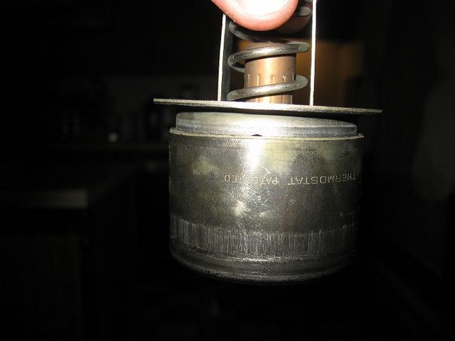

Default Re: Strange engine heating problem (new)
Defective part. See how crooket it is. It's not closed and I'm holding it. It's cold. Also notice the high ware area.

Location: Laplata, Maryland
Posts: 510
Congrats. I thought I remembered posts about problems with aftermarket thermostats in Gen2 cars....

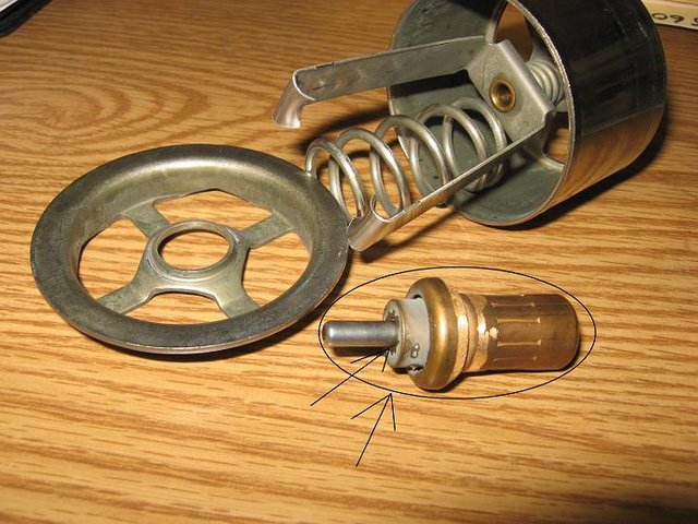

Failed component
Pin would not slide, stuck in position.

It was a good reputable dealer and this is the first one he ever seen fail. It is a Weir-Stat brand. I’m going to cross section this component to analyze it. It appears the pin got sticky and would not slide. Possibility is to close of tolerance.
